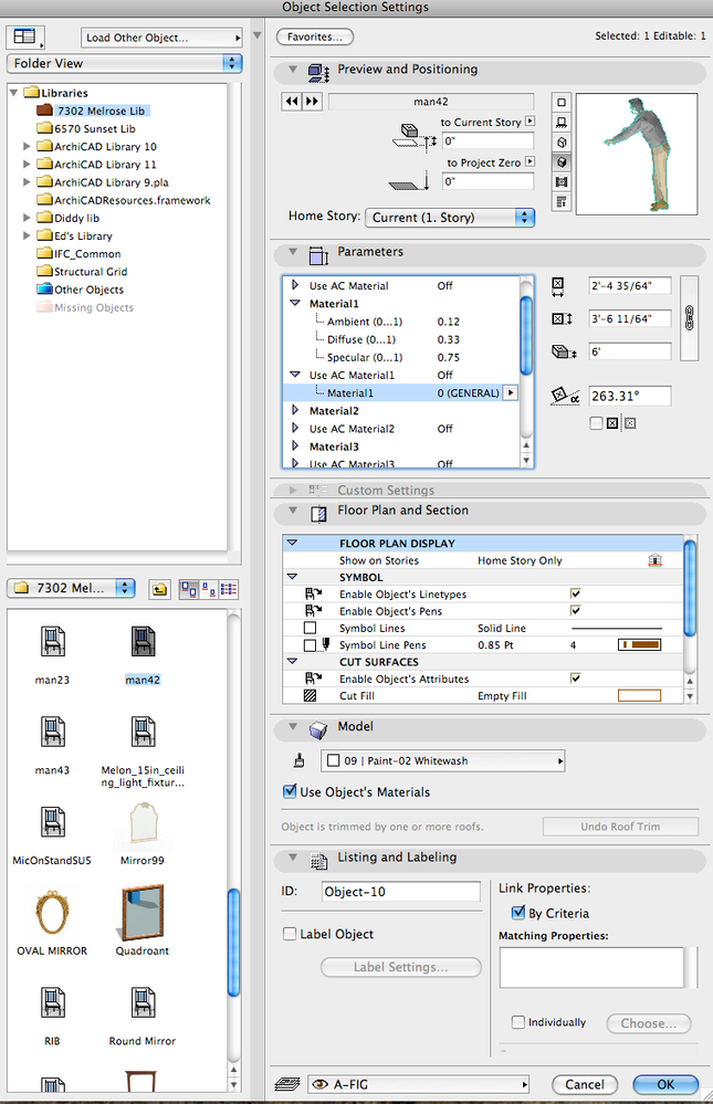

Does "Use Objects Materials" in the Object dialog help restore the imported element?
Dwight Atkinson
The Objects materials render with the mirror finish. Only with LW. I can change the individual material parameters to ArchiCAD materials, but each object can have up to a dozen parameters.

Here is what I don't understand. When I import a 3ds model it has its native materials. These materials are not added to the general library. Where are they?
I have the option of overriding the native materials and substituting one from the materials library.
undefined
as far as i have noticed so far, the native materials that are attached to the object b4 the import don't convert into ArchiCad at all.
it creates the 'specular diffuse and ambient' values that the material requires, and associates to [General] (well for me any way)
Generally after converting a 3ds object into ArchiCad, i would place the object in the work space then 'Ctrl + Shift + O' to open the object.
Then redefine the 'labels' for materials and change the defaults to some thing that i would generally use. This helps tidy the object parameters up a lot.
PLUS a 3D preview saves a lot of time if you can paste an image into that slot when browsing your library.
If by chance you do happen to find out how to use the native materials without going through a 'create new' process i would love to know.
