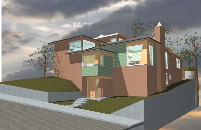

I sometimes get incomplete shadows and sometimes do not...with the same file I believe. Anyway to correct this.
Thanks, Paul
4 Replies 4
Check your 'Photo Rendering Settings' and make sure you have shadows enabled. Also if you 'saved' certain 3d views under your view sets, be sure to redefine them accordingly after you had enabled shadows.

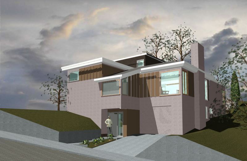

Thanks and yes that was my first try also...but see this view....
Interesting, this reminds me of another post regarding an 'egg shell' problem. Here is the link, Dwight gave a few suggestions:
Egg Shell Problem
