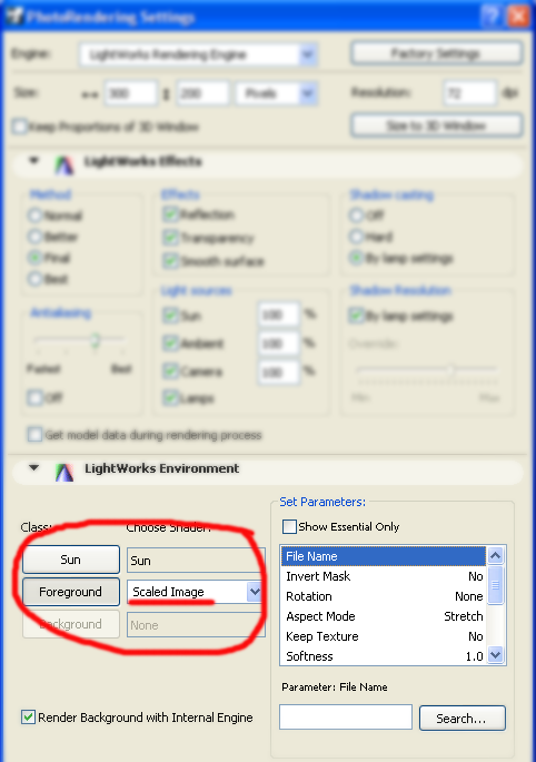

Also, you can do this in Archicad (I think). Go to the lightworks rendering settings, and under the Lightworks Environment menu find 'Foreground'. From the Foreground menu find the 'Scaled Image' option, and then fill in the blanks on the right hand side. (See Attachment).
I haven't actually done this before, so not sure how well it works.
Trying to get Tom's suggestion of using the foreground option to place a logo on a rendering (for a movie so photoshopping each frame is out). Has anyone had success with this? We can't get the settings right to get the logo to display without it's background affecting the image, or using a small image without it stretching over the whole image.
Any suggestions appreciated, thanks.

hmmm. i just had a play following my own instructions and can't get it to work either. I'm sure I had it working ages ago, but that was another office in another country, so I can't check the file....
Sorry.
As you are on a Mac, you'll probably have iMovie - have you tried using that? Here's a link to read: http://www.macosxhints.com/article.php?story=20080104184141611
My colleague is going to try the iMovie solution. Very annoying. Thanks for your help.
FWIW I tried saving back to AC10 too, and no luck there either.
Anyone else had any success using the Foreground method? Or is this another feature GS have "fixed"?
