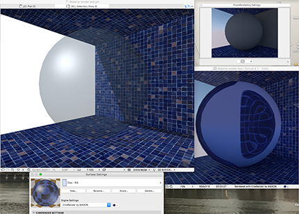

Another example:
For both these reasons it is still often necessary to make a rendering frame just to test. I have now managed to set up a few simplified scenes using a limited range of settings. I still have to find out, though, why som surfaces render black (without color) in certain scenes.

Yes, I think you mean the small pic on top in the PhotoRendering Settings window. It is not always 100% consistent with the final rendering. Nor is the small preview "ball" in the Surface Settings window. I guess it is partly because the environment settings also have an impact on the final result (sun, lamps, etc.)
