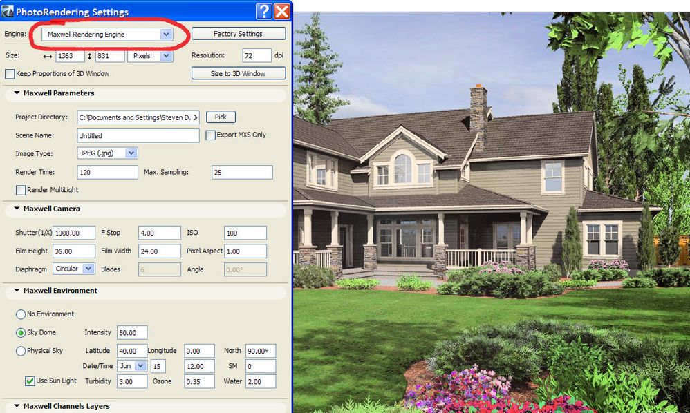

Maxwell will start automatically if you have selected the Maxwell Rendering Engine.
