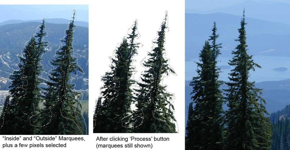

I'd forgotten that I hadn't posted a sample here yet.
I'm finding Knockout pretty easy to use and much faster than masking by hand for complex masking. (For straight-edged objects, or those on a contrasty background for which a combination of magic wand and brush-masking work easily, Photoshop is probably just as fast.)
Attached is a composite with an example. The first image is a view from the ski hill with a couple of trees in the foreground. Two marquees have been drawn - very loosely as you can see. One is the 'inside' marquee - encompassing pixels that belong in the masked image; the other is the 'outside' marquee. Knockout seems smart enough not to select all pixels to belong to one set or the other - but to vary the pixel selection around the border.
The middle image is what is seen after clicking the 'process' button. The marquees were drawn in 10 seconds or so, so this process was pretty darned quick. If I had to mask within Photoshop - whether the extract tool or magic wand, or layer masks/etc - it would have been a longer process than I care to time at the moment!
You'll notice a bit of fringing - the mask isn't perfect. I fine-tuned it quickly by using the pixel selection tools to click on a few pixels in the boundary area that 'belong' to the outside and a few that 'belong' to the inside (seconds again). More time could be spent making the image perfect, but I wanted to see what 30 seconds of work looked like.
The third image layers the knocked out trees on top of another photo (and rotates them so that they look more sensible). I can see a few problems that I would fix if this were real, but not bad at all for very little work.
The price was $69 plus shipping for US Wacom owners at:
http://www.wacom.com/privileges/index.cfm
Can't say if it is worth the $$ until I see how much I use it, but seems like something handy to have in the arsenal. May download the free trial of the Extensis product that Dwight mentions out of curiousity.
Karl
PS If you're using Internet Explorer with the default settings, the image will shrink to fit your window and will look pretty bad (once you click on the thumbnail below). Hold your mouse over the image in the new window until you see an orangish button (with blue arrows going out from each corner) at the lower right of the screen - click that and the image will be full scale.
