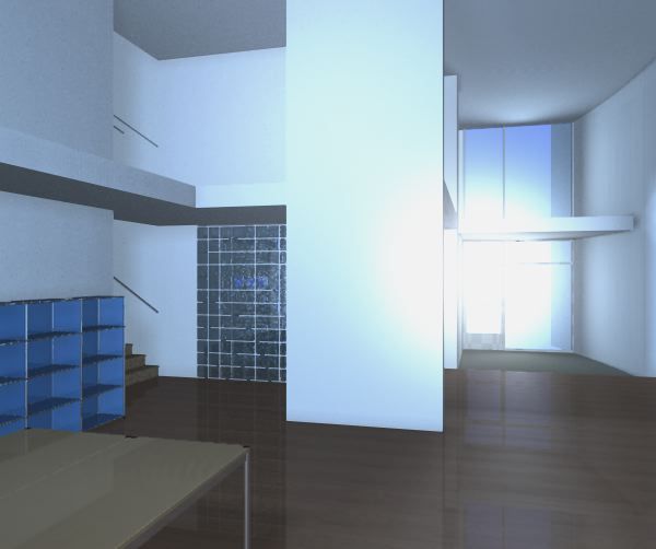

I have used sun- and heaven- and window object, and I shut off the sun in 3D Photorealistic option.
Camera 100%
Ambient 100%
Lamp 100%
If the intensity of camera is 100%, than the window is too much sunshine (please see the picture.)
But under 100%, the inside room is very dark.
Can you help me?

sunlight is yellow. any windowlites coming from the direction of the sun should also be yellow. other window lites match the sky color.
Think like a photographer would.

Thanks Dwight.
The lite with LW is very sensitive, and at the same time it is very interesting to learn. Unfortunately it needs very much experiance with know-how.
For example, the lite color has so many possibility.
You say simply yellow, but there are so many yellows.....
If I make everything yellow, than it is pure yellow.
So I have tried to make sun lite yellow with 30% intensity, and other lites are just white, and with general light also with white.
I think, the result is not so bad.
How do you think?

The way we determine ambient, sun and sky colors is by sampling photography. Look for the whitest thing in the sun - yellow tint.
And the whitest thing in skylight free of sunlite - ie open shade. That's your blue.
There is no such thing as white light. If you think light is white, it is because it is overexposure or glare. Try brown ambient sometime.
Incandescent light is quite yellow, relative to sunite.
This is about tints, not strong colors.
