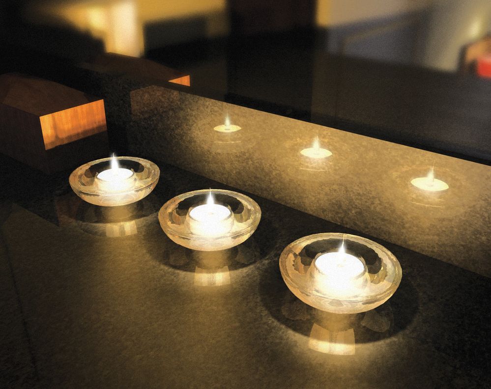

and for the surrounding light - the most versatile light is the wall light indirect that makes diffuse glow around itself..... scroll to the bottom of the parameter list.
These candles use that light
