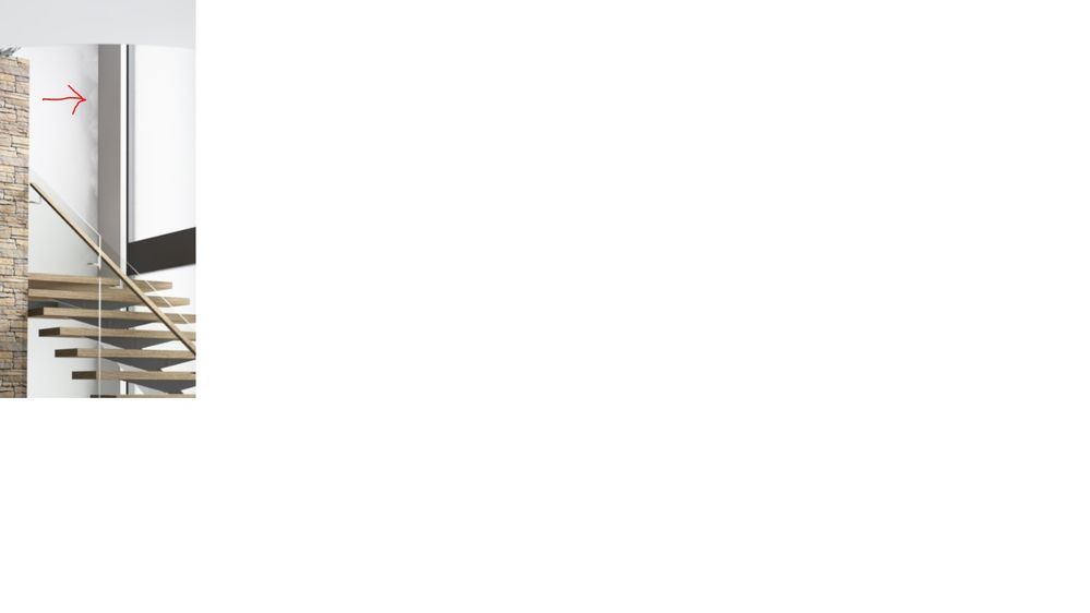

Light bleed in corners
Has anyone come across these artifacts in Cinerender?
Not sure if it's a setting or bug.
There is no gap between the walls
I have a window light located outside the adjoining window...
and a sun object externally
thanks

Hi, should be related to GI settings...you have to increase/adjust samples
Katalin Borszeki
Hi, without looking at your specific file, we can only suggest some generic articles on the helpcenter to help figure out the lighting problem...
please check "Force Per-Pixel" settings here:
https://helpcenter.graphisoft.com/guides/archicad-20/archicad-20-reference-guide/user_interface_refe...
and this article might also be useful:
In case you would like us to look at the specific problem, please PM me a file!
