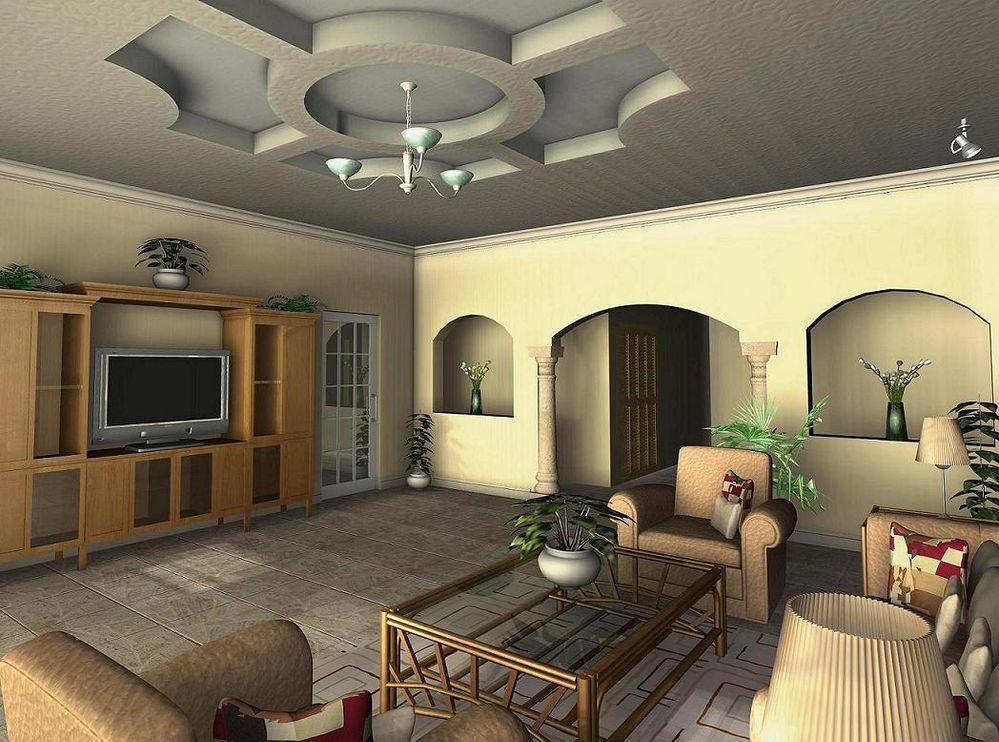

Living Room Interior (WIP)
My work in progress. I would like some questions and comments on it. I also have an animation of this room that i did. If you wanna check it out just pm me for a link.

ArchiCad 9 render? I like it, I always be impressed when I see indoor renders like that.
Hi Kjverine
I like the materials that you have used.
Just something I noticed - the camera angle for this shot seems a little weird because everything seems to be in a "pyramid" kind of slant towards the ceiling. I had such comments from people before about my renderings when I started giving it a go, and found that I have to tilt the roll angle higher to straighten things out.
keep your eye level and target point level at the same z-value, and your verticals will remain straight.
Very nice, how are made holes in the roof? using GDL?
Is it made in ArchiCAD?

For some time now, archicad has been able to cut holes in slabs using connected lines or fill shapes. It involves the magic wanding of the shape with the target slab selected to create the void.

The surface structure of ceiling and wall is different.
It is strange for my eyes....
Clading structure for ceiling,and wallpaper for walls...
The surface of ceiling should be almost same like the wall in my opinion.
Dwight
Most interior spaces have a white ceiling to balance the effect of the wall color.
Since the rendering mistakenly includes lots of ceiling, you see it as a part of this scene, but in real life, rooms are too small for the ceiling to be part of the experience.
Unless it is the 1600's, and you are at the Vatican getting dressed yet another time to see the Pope. Then the ceiling is important because they make you wait for days and there is no television or off-track to occupy you.
Rooms would become dark and deadened with color if the ceiling didn't provide some neutral light reflection.
