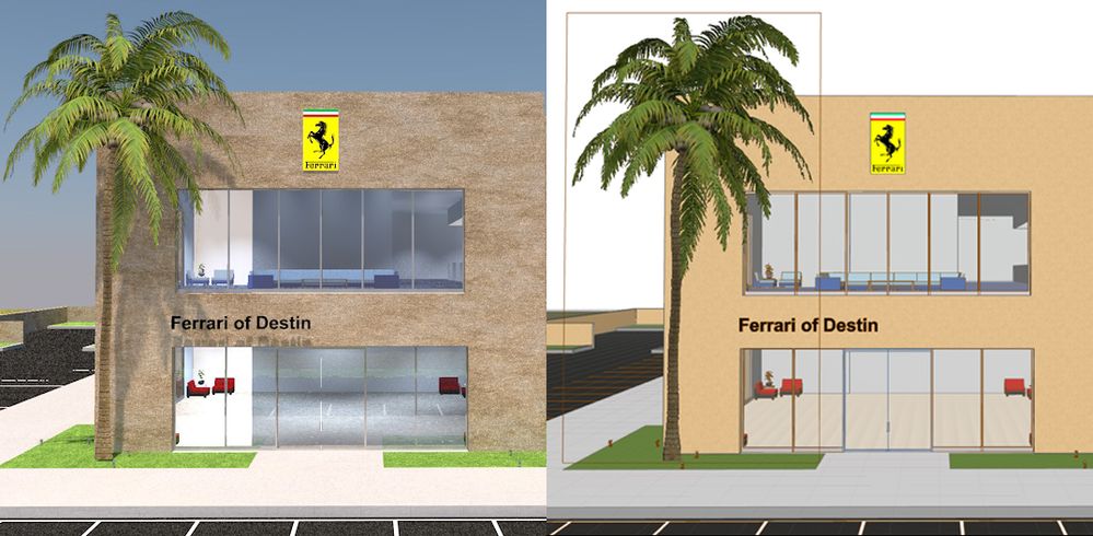

I have seen some other references to issues with plant materials being solved using Physical Render as opposed to Cinerender. I have not yet tried that but my problems seem to be that the "bounding box" if the plant material seems to change the transparency of the window behind it. I also ave noticed that the specific Palm Tree out of the standard library that I am using seems to need to be replaced with each new view as it only seems to be visible in 2D. Attached is an image of the render and the 3d view.

I have been able to get this to work using "Physical Render but the results are very grainy and not acceptable. It seems in your examples you were able to solve the problem without using Physical Rebder.

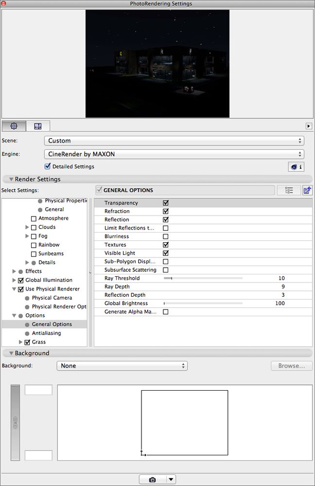

I also have customized the Rendering Settings as prescribed by Graphsoft to get window transparency as the attached shows.

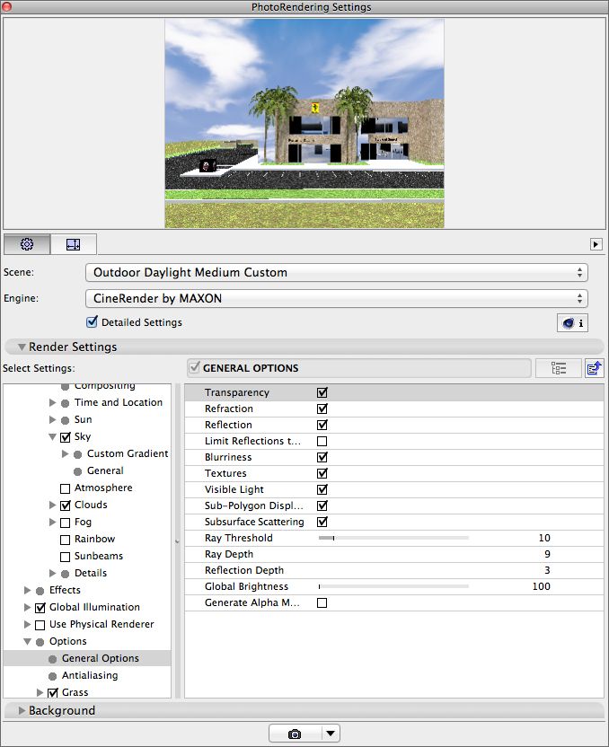

I had posted this problem recently but did not get the response I need. As you will see from the attached when using Cinerender the bounding box for the palm tree affects the final render in that it prevent transparency behind the bounding box. While we have solved this with physical render the quality of those images are very graining at not really acceptable as we need near photo realistic results. Another member mentioned that they could not duplicate thus problem but we are stuck at this point. Any suggestions for modifying the rendering options or changing plant materials would be appreciated.

I haven't oticed in the CR settings... But there may be a slider that determines how many transparent surfaces light can pass through, to limit computation time. Your screenshot makes it seem that only one surface is transparent with your current settings. Just a hunch.

We have double checked the CineRender Settings as per the attached and have the Transparency Settings as prescribed by Archicad and as we are getting some of the windows to be transparent that seems to be working.
The issue is the bounding box of the plant materials seems to affect the rendering to actually let more light pass through rather than less. We can solve this using the Physical Render but the results were very graining and not acceptable.

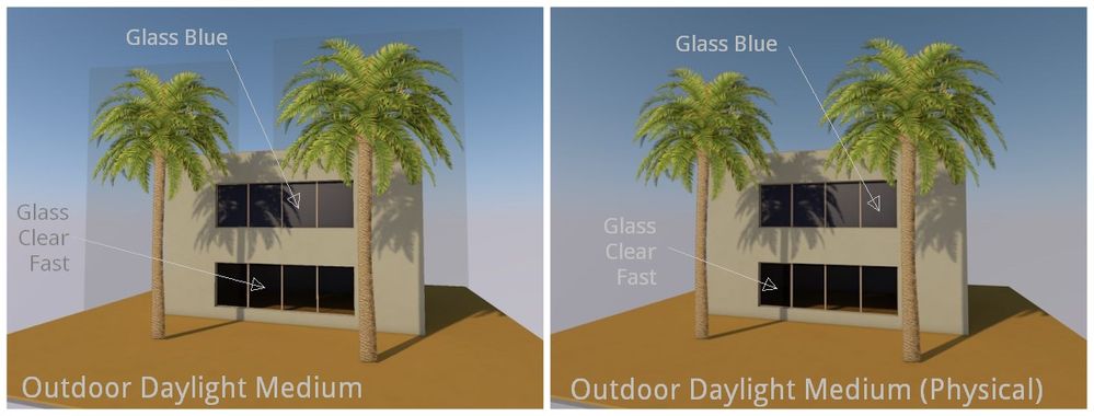

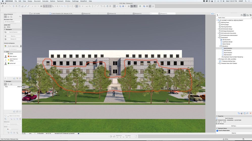

Did you ever find the solution? We have had this problem on our last two projects, and some preliminary renderings today show that we're going to have this problem again on this project.
I don't even know how to describe this problem... it's as if the transparent plane of the tree cancels out the reflectivity of any transparent surfaces behind it? Or the transparent plane of the tree "artificially lightens" the transparent surfaces behind it? The same thing happens when we look through two glass surfaces. (Please see the attached examples. I have also included the .renderingscene file so that anyone interested could try it for themselves.

In this particular case the glass being used is the Glass: Clear, Fast*, but the problem happens with the other glass surfaces as well.

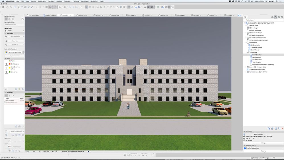

Same view, but with no trees. Please compare and note the windows are problem free.

Different project but similar problem. In this case the areas circled in red are where we are looking through two glass railings.
