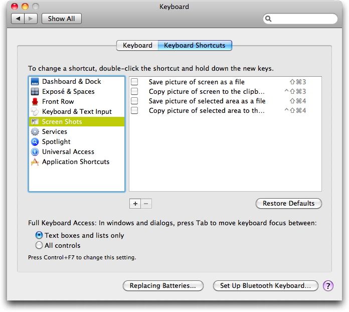

I'm puzzled by your configuration. If you have an iMac, why not install and use the Mac version of ArchiCAD rather than booting into XP through Bootcamp? If you use the Mac version, a variety screen-grab function are available. Usually cmd-shift-3 to take a snapshot of the whole screen or cmd-shift-4 to take a snapshot of a selected area. You can check the configuration for your Mac using the Keyboard settings in System Preferences (I've attached a snapshot from Snow Leopard).
However, the best option for exporting drawing for display purposes is usually PDF.
