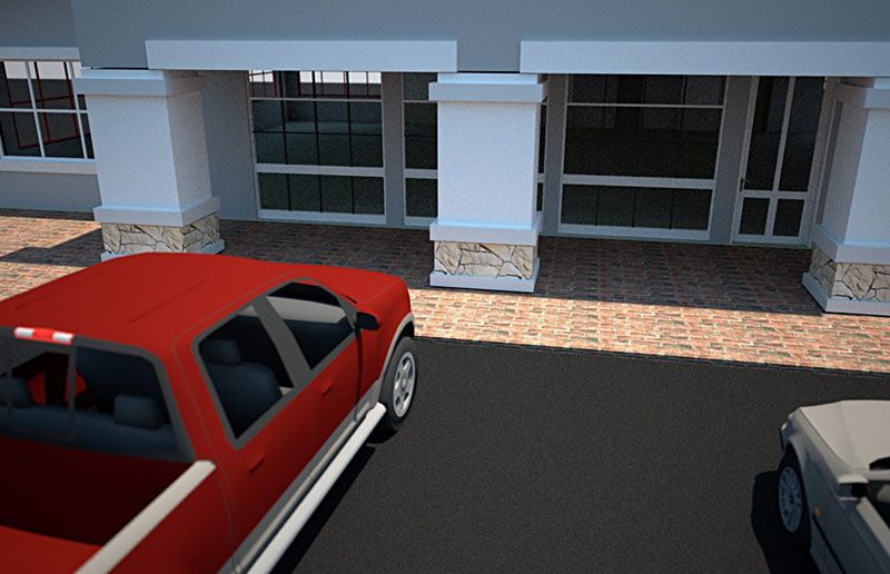

NOTE: I had trouble with the download, my Stuffit expanded the file into a normal folder called MAXWELL - I needed to collapse the folder (close it) and then rename it MAXWELL.gmx - then it behaved like a normal super powered plug-in. This type of rendring engine plug-in is just what the doctor ordered. Great stuff. Enjoy.
As far as ease of use, C4D is fast and easy as long as you don't invoke Global Illumination.
I really like the physical sun of Maxwell and the real time adjustment of renderings while they process. I don't like the time necessary for a good clear image when the light level is low.
So far, I don't know how to get ArchiCAD billboard objects to render correctly and I haven't messed with Mxm materials inside of ArchiCAD yet. The materials in these example images are straight from ArchiCAD. I hope these image postings are not annoying. Now that most of the technical hurtles are over in regards to Macintosh version plug-ins. It might be a good time to create a better work in progress.

The real problem of the integration in ArchiCAD is the low texture quality of the default ArchiCAD materials. You can make a nice model, but you have to either replace all textures with better ones (high-res, less visible tiling, less saturation) or define/load a Maxwell material for each used material. This can be cumbersome.
But if you want the best result, you should probably go the extra mile and make some thumbnail sheet for maxwell materials and apply them. Especially tricky materials such as glass, chrome, aluminium and velvet will never look great when you only use a default ArchiCAD material + texture.
In fact, that is often the problem with ArchiCAD renderings: try to apply decent textures or replace all materials with optimized materials for your rendering application of choice.
I've tried the ArchiCAD 10 plugin to render with Maxwell and the process is smooth. I was struggling with the Maxwell textures in the beginning (the additional downloads), but once they were into place, the renderings using Maxwell materials were significantly better then the ones using ArchiCAD textures. Now I have to get rid of the demo-watermark 😉
