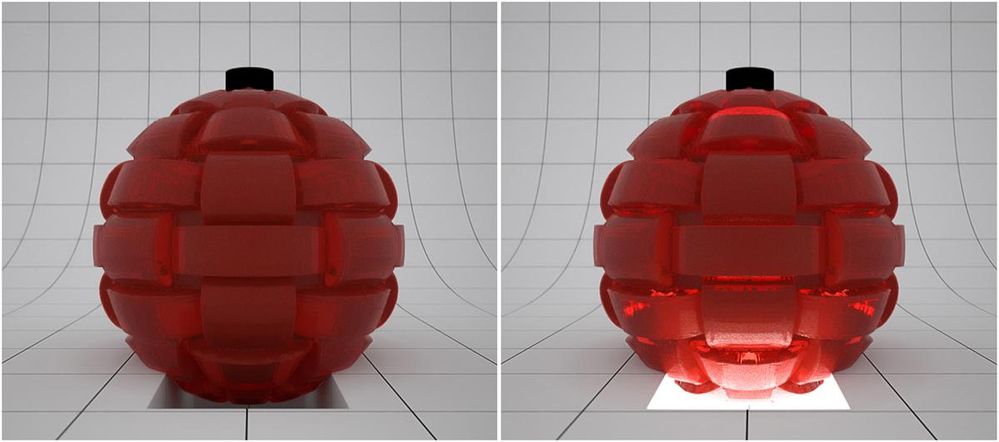

Images from Maxwell forums Link
Was this done in Studio or with the plug-in?
Pretty cool.
