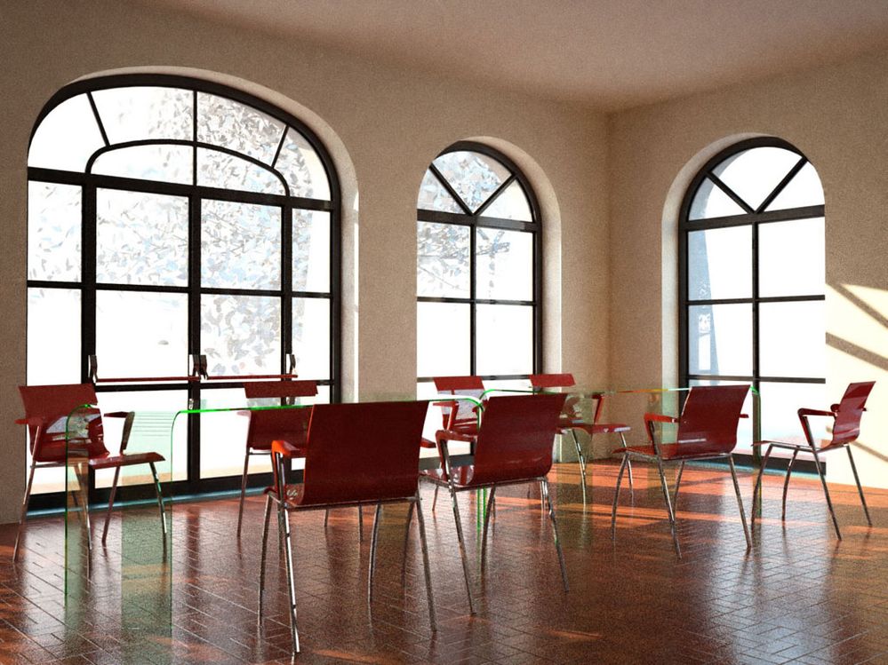

I love Maxwell Render!! Some works modeled in ArchiCAD and rendered in Maxwell 😉 😉
Respect to all of you, especially Pietro and Burginger 😉!

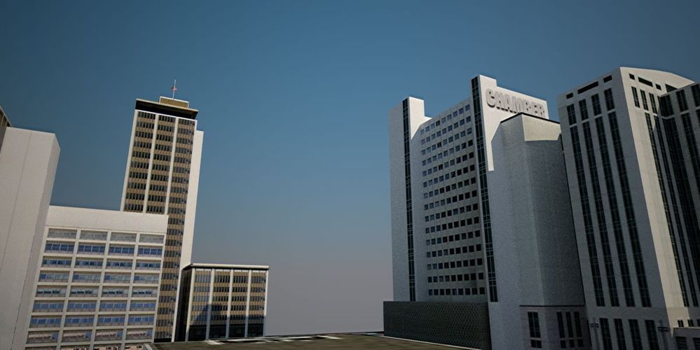

Maxwell is compelling but there are times when I just struggle. For example visiting the site: http://www.vterrain.org/ I downloaded a 3Ds scene and brought it into C4D, sending it to Maxwell worked fine, but now I can't render a HDR scene. I posted the file at: http://www.Burginger.com/MAXWELL/Maxwell_PacknGo.zip 4MB
HDRI global warming type effect. The scene is San Diego.
EDIT NOTE: Adding the HDR to the reflection and refraction channels cleared up the problem. Go figure.
