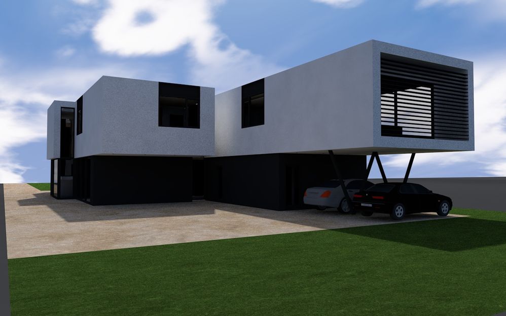

I encoutered a problem with a project I was working on.
When rendering the image, some walls were missing. Those walls should be visible behind the window, but disappeared.
So, we have horizontal bars - balcony - sliding window - room. In the room, the wall vanishes. This occurs in different places in the model, but not always.

I have seen this on occasions with students where there was a hidden layer in a composite with thickness 0.

I think I figured it out.
If I increase Ray depth and Reflection depth, the problem is solved.
Took me a long time to figure it out because in the preview this change is not shown . Hope this saves other people some time.
Jeroen
A new day of problems, but with a solution:
next to ray depth and reflection depht in de options menu,
also increase the shadow depth.
