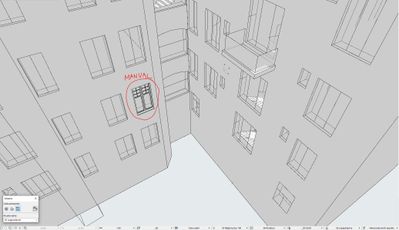

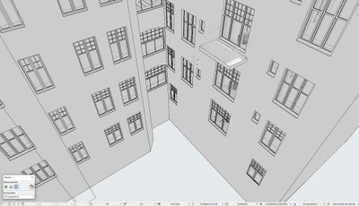

Has anybody experienced a similar problem? Attached are two images one from the current file and another from backup. MVOs are identical and so are all the other view options. The window, door, railing detail levels are set to full in both, yet in the current version they do not change. I can still go set the detail level manually per object as marked in the image...
Current (bugged):

Backup:

Well, I upgraded from the latest Archicad 25 to Archicad 26 and the problem has been fixed. Some weird bug I guess.
