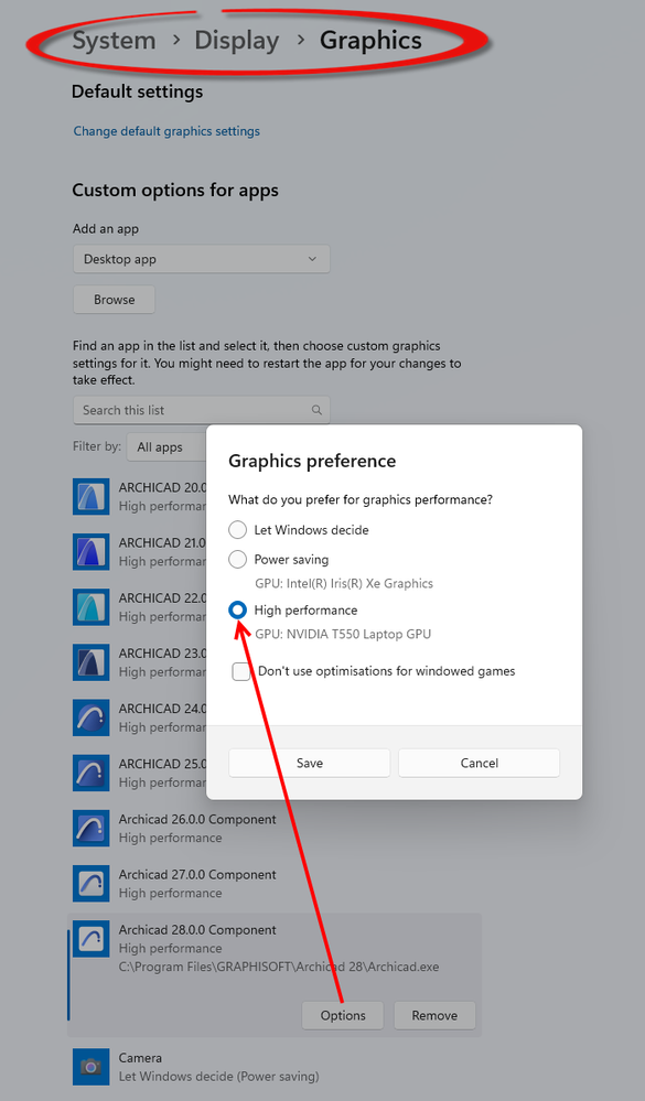

I am not sure if this will help or not, but make sure Archicad is set to use the dedicated GPU and not the built in one.
Go to Settings > Display > Graphics ...

Set it as you said, but sadly no improvement. Could there be some setting within Archicad which could help to tweak? I read disabling bakground updating can improve performance, but weirdly it made no difference for me. after testing In advanced redraw options I set memory to max (it was set to nearly max) as I obviously should have enough memory. 2D drawing hardware acceleration is greyed out but it is set to max. Model display is set simplified for 2D navigation.

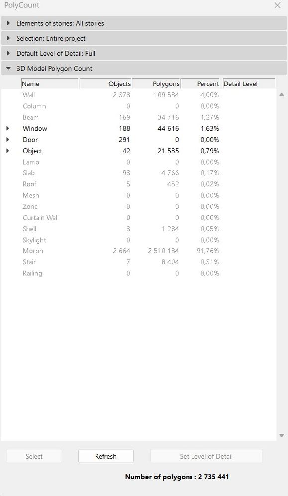

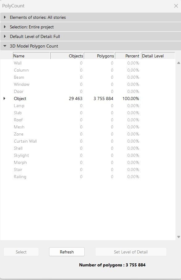

Landscape model onlyLandscape model onlyChurch projectChurch projectFirst one is for a file of 1,8GB containing a landscape model only. The model is scaled down to 1:1000, so when I try to scale it back to 1:1 it becomes either a model consisting of many black points (no surfaces), or it simply doesnt load in either 2D or 3D (infinite loading). Of course this is a big file so I dont expect much there.
This second image is from my church project. File size is just under 300MB
NOTE! small correction from previous post, I meant file sizes of 300MB, not 30MB
First project:
If you try to display a terrain (Mesh element) in 3D and it shows only selection hotspots but no surface, that usually means that the data structure of the element is damaged and it cannot be generated. When something like this happens, I try to start a brand new project based on the default Archicad Template, select the mesh, and copy-paste it into the new file. When Archicad pastes it, it will try to repair its data structure. It may or may not be successful, and if it manages to repair it, it may be at the price of having to delete surface points from the Mesh that caused its 3D to degenerate. But it is worth a try.

I can see that most of the 3D polygons are coming from Morhps. Can you show Floor Plan that gives us an idea of the type of Morph elements you are modeling? Also, can you select an element where there are many SEOs performed on an element and show a screenshot of just how many (dozens, hundreds?) When the element is selected, the SEO handle will show and it will indicate all the SEOs performed on the element. SEOs could be a source of performance issues.
