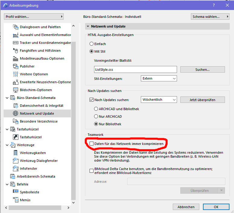

torben_wadlinger
Rockstar
A really underrated (and often unkown) feature is turning off network compression!
I'm a German user, for that reason I can only guess how the English menu names are. But look at
Options > Work Enviroment > Network and Update
Turn off network compression
