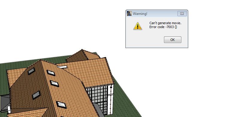

Hi! I tried to generate a nmovie and an error shows up, see attached file
Any suggestions?
Thanks.

Dear Giuseppe,
Usually this error message shows up when you try to save more QuickTime movies to the same folder at the same time. I recommend creating a new folder for each movies.
I hope it helps.
Best regards,
Katalin Takacs
Thank you!
I thought it was because I stopped the process of generating movies and I didin't delete the remaining file.
