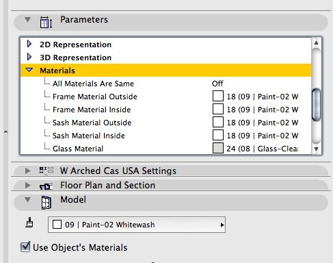

1. I want to use aluminium framed windows. I used the tilt and turn window frame which had the default setting as a timber frame-in the window selection settings under the model tab I unchecked the box "use object materials" and selected alumium instead but it then changes everything to alumium including the glass panels-how can I make the frame aluminium and keep the panels as glass?

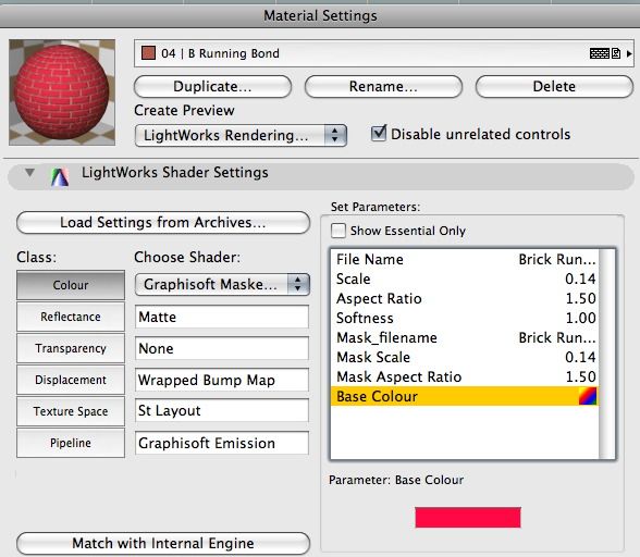

2. I want to change the tone of the french brown roofing tiles but even when I change the colour and light settings dramatically, the texture of the tile seems to override the other settings and the colour remains pretty much the same-how do I keep the pattern/texture of the tile but change it to a grey hue instead of a red one?
Brenda:
As you have discovered, if you uncheck the "use object materials" box, the entire object is then made one material, so this is not the solution. The window should have some parameters for setting the materials of the individual parts (glass,, sash, etc). If you tell the forum the name of the window you are using, someone will probably be able to tell you where these are in the window's dialog box.

1: Windows:
You need to use the "use object materials" setting and go into the dialog to change the specific materials.
2: Roof Tiles - can't change color.
When you render, the surface is a picture - called a texture map. If you are rendering in LightWorks you tint the material in the dialog below. OR: You duplicate the material and change it in Photoshop.
Dwight Atkinson
