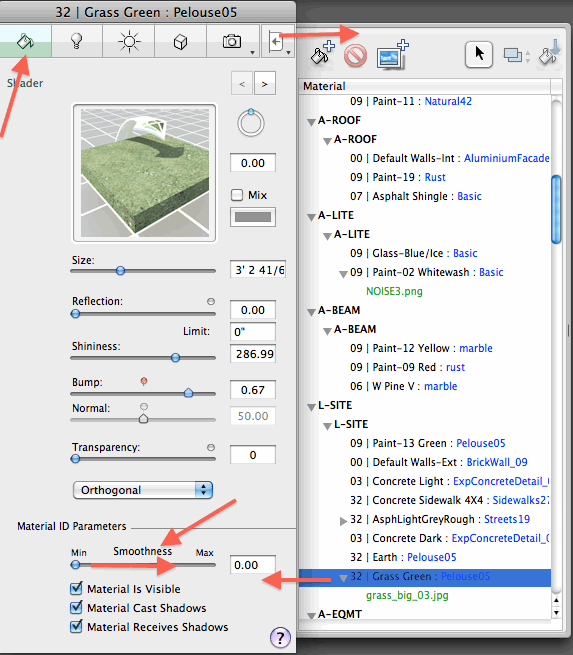

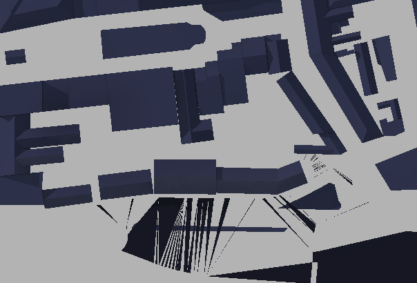

Ok I've fianlly built the City in ArchiCAD (took about 18 hours in total, excluding the train tracks)
I've run into a problem: The roads were created with the mesh too in ArchiCAD because slabs next to the train track causes huge problems and crashes...
I now have contour lines showing up in artlantis render ( plus I can't get the lighting like I had it before which is also annoying!)
Is there anyway to 'hide' the contours in either AR or Artlantis, bearing in mind all points are at the same level.
Thank You
Karl Ottenstein
Moderator Emeritus
Most likely that can be addressed by adjusting the surface smoothness slider as shown in the attached - at least to midway if not max.
Note that if you select a surface with the Material Inspector, you will not necessarily get the object and thence the slider, but may get the texture mapped to the surface. Open the tray, as shown, to select the actual object and you'll then see the smoothness slider.
