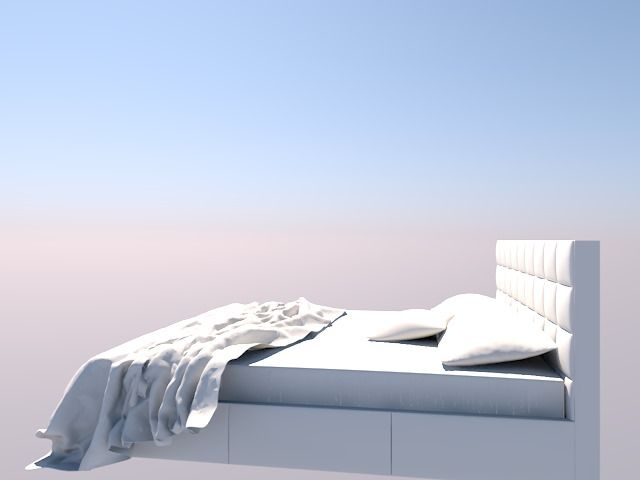

Int_Skylined wrote:Yes I used Cinerender to render. I read online that when I add an object, Archicad puts it into general surface which I guess is why it's coming out gray. Is there a way to make it use the default surfaces the object came with?
Do you make rendering via Cinerender?
This render engine based on separated set of materials.

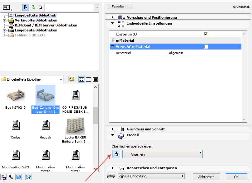

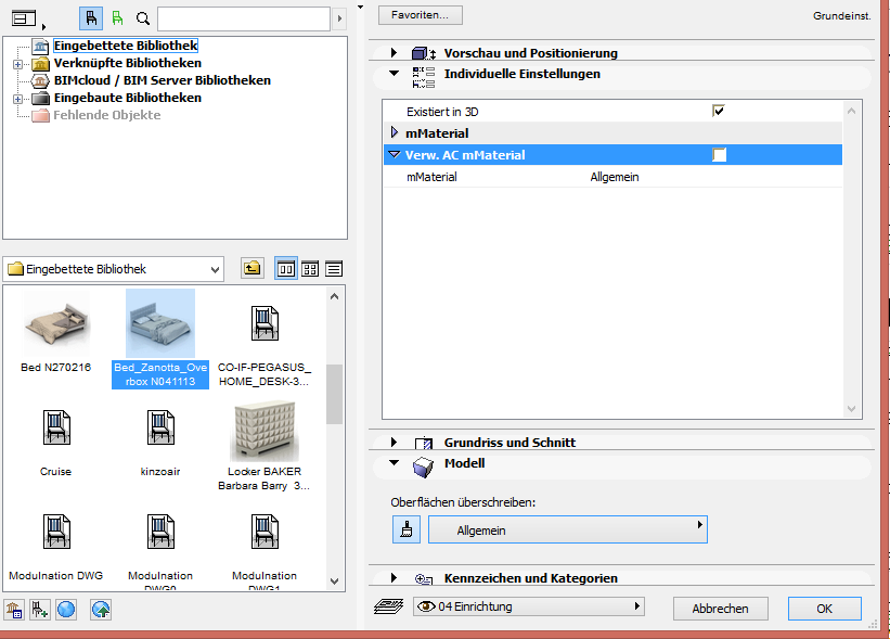

Int_Skylined wrote:I am showing an example, I downloaded it from archive3d.net in .gsm file format and I added it to my library. In settings it set to General but if I change it it changes the entire object to the same color.
For advanced help I need some details of that objects on screenshots: what's objects (imported?), which material options was set, etc.

Int_Skylined wrote:I rendered it on it's own fo example purpose,

ā2016-06-19 09:40 PM
Int_Skylined wrote:I did that and the render is still gray.
You should to uncheck this button.
