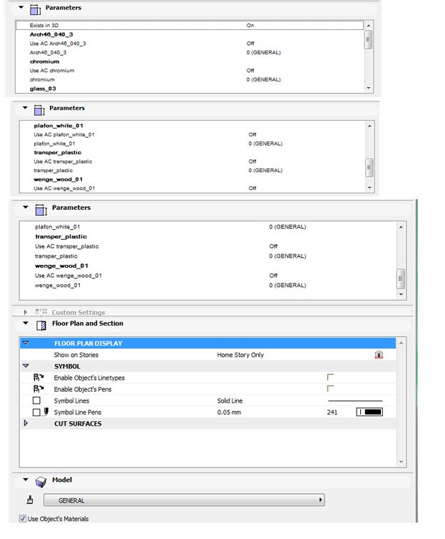

I'm still having the same problem. And I just don't get why...
example: http://www.archibaseplanet.com/download/21804.html
I've been trying to use this cabinet. But the same thing happends.
Something is wrong. It still get's greyed out.
You may try to download it maby and see if it workes for you guys?
Three materials follows with the file:
"arch22_wood_011"
"BUCHENAT"
"Woods & Plastics.Finish Carpentry.Wood.White Ash"
And in the parameters Archi Cad lists up a lot of materials (see picture)
The materials is in the library and the library is reloaded and there's
no duplicates.
I've heard a lot of talk about the website I'm downloading from and you guys don't seem to like it very good. But I don't see why anyone would make a website and upload thousands of objects that don't work!?
Hm...
edit: By the way: I know the materials here is set to off, but it don't help if I set it to on. The object just gets a "lighter" grey tone after the rendring. But it's still grey...

Try loading all the default libraries (those that were installed with your Archicad), then add this library with the Library Manager and Reload, Don't remove the standard libraries unless they cause trouble.

I took a quick look at this object. If you change the

That was a good tip, I didn't think of that.
So now I've changed the materials and it workes great
But still, it's enoying that I can't use the materials from the download.
I've also downloaded some people, and I can't use the AC materials in such an object. (because of hair, eyes, skin etc..)'
And I've downloaded sofa's and such with special fabricks..
I hope I will figure this out somehow.. Some objects work tho!

Reeves wrote:Yes 3ds is the format used be 3D studio max.
Can the problem be that a lot of these objects are 3ds and not gdl?
3ds is for 3D Studio Max right?
Archibase mainly convert their models from 3DS models because it is easy (using the 3ds converter plugin) and they are giving them away for free.
They are never going to be as good as a native written parametric GDL object.

Reeves wrote:You can use the jpg files included with the download by assigning them to the materials used in the object. Search the ArchiCAD Help files for "texture" for more information. The textures only show in the 3D Window when set to Open GL, and photorenderings.

David wrote:Ah, smart. That worked great
David
This, of course takes some time, but anyway..
Thank you for the help David!
