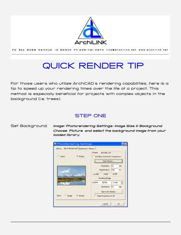

Quick ArchiCAD Render Tip
Attached are some images of a PDF that provides a tip for creating quick renders in ArchiCAD.
I created this for my clients, but would like to share it with the ArchiCAD community. Due to the size of the file I had to split it up into 5 images and you'll need to click on each image and maximize your window to see them clearly. If you would like the entire PDF, please send me a private message, by clicking on the 'PM' button at the bottom of my post.
Cheers,
Link.

Page 2:

Page 3:

Page 4:

Page 5:
