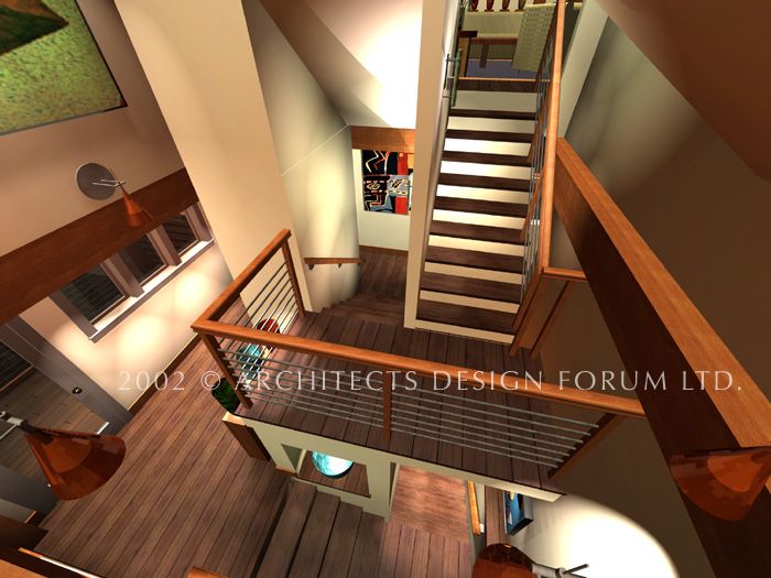

Problem #1
I do fair amount of interior renderings with lighting in artlantis ( I should say, I try to anyway). To be clear, I will set 20, 30, 70 lights in a model, some down lights, some general lighting to get as close to "photo realistic" as possible (see attached image) with in the limits of the software. Artlantis allows 128 lights.....how they picked this limit I don't understand, but I am not exceeding the limit, though I could if the program would let me.
It is frustrating to no end, when I have the lighting dialogue box open and try to re-arrange my list of lights, once I have place several lights in the plan in artlantis, the program will eventually CRASH. Usually only after I have been doing two hours of work and have not saved changes.
If I am "tweaking" light settings while switching between individual lights before the preview window completely refreshes, the program will CRASH!!!!!!
It has gotten to the point where I have to save my file virtually every two "tweaks" of lighting or I am in danger of losing data. Problem with this is it takes a long time to save the file if there are alot of lights or polygons.
The program is fine with a couple of lights, but if you try to get into realistic lighting with many lights, the progam just craps out. I have written to Abvent, but they just ignore the problem......big surprise there.
By the way this problem has occured since v3.5 of arlantis.
I use a G4 933 with 1.5 gigs of RAM and a 120 gig hardrive. Its not the machines problem, it IS the software, it is very unstable when it comes to minipulating many light sources.
Problem #2
Light from general lights in artlantis passes through walls and floors.............why?????? This really screws up a rendering and forces me to set up lighting different for different views, this should not be the case. I don't know what walls are made of in France, but I'm guessing light does not pass through them.

Problem #1
About Art*lantis crash when re-arranging the lights please update your Art*lantis 4.5 into 4.5.6 at:
http://www.abvent.com/us/software/artlantis/update.asp
Why Art*lantis manage only 128 light sources? We had to put a limit, do you think it's easy (as Art*lantis is today) to manipulate 128 lights sources? above all when you need to change their status, so isn't it better not to place light source as they are in the reality but simulate the reality with less light sources?
Problem #2
About the lights which pass thru the walls. This is a well known problem links due to the way Art*lantis manages the geometry and the materials. Nonetheless 2 ways to avoid that:
1- If you put lamp shadows at 100% no more pass thru wall
2- e.g. you have 2 rooms side by side, you have no light on in the scene except in one of the room your lamp has shadows at 70%, put a camera in the other room, you might see the light passing thru the wall. put a lamp in this room if the light of this other room still disturb you switch it off.
Now we are working on the future Art*lantis version which is been completly rewritten and free of "dust". So trust on us for improving our product and giving you the best rendering solution you have ever dream.

Dear Robert,
1- If in 4.5.6 version you keep having crash problem while managing the lights I'll be glad if you could send me an .atl file getting this trouble, so I'll check it.
2- I don't know the project size you are dealing with but I'm still quite impressed that you need so much light sources, so if you don't mind I'll be glad to take a look at one of your .atl file so this way the discussion will become more concrete. (Files you could send will be for internal use only I will open you our ftp web site to upload).
3- Lights passing thru walls, such it is with Art*lantis since the beginning. This can't be fixed in the actual version. Technical choice and compromise had to be taken.
You are welcome to participate to the future betatest of the future Art*lantis version.
