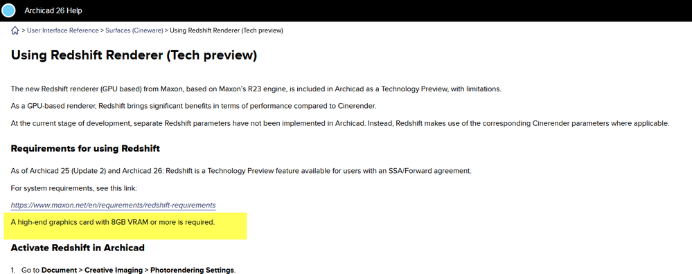

Hi, can any experienced users with the Redshift Rendering engine please give me some feedback on how it is performing for you and are your happy with the results ?
This article below highlights the limitations in AC25 & AC26 are all these limitations still applicable ?
https://help.graphisoft.com/AC/26/INT/_AC26_Help/140-3_Redshift/140-3_Redshift-2.htm#XREF_34278_Curr...
Thank you in advance.

That article is from the Archicad 26 Help files, which can be updated whenever any change happens in Archicad, so the answer is yes, what you see written there are the current limitations.
Given the pages and pages of bugs and limitations, one has to wonder why Redshift is even delivered to users in its current state.

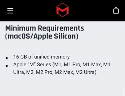

Hello, I am trying to use the redshift renderer on the following configuration: Mac Mini M2 16GB RAM, but as soon as I switch to RedShift I get the message stating that the hardware configuration does not support redshift. Is there any further requirement that I am not aware of?
Thanks a lot
You need a suitable video card.
From the Help file ...
https://www.maxon.net/en/requirements/redshift-requirements

Thank you for your reply, but that specification page is exactly what is not clear. Following those specs for Apple Silicon I should be able to use Redshift (minimum specs being 16GB of RAM and any apple silicon processor. Note that
on apple silicon the GPU is integrated).
Does anyone have experience on using Redshift on such a machine (MacMini M2 - 16GB RAM)?
Sorry, I know nothing about Macs.
I didn't even now Apple Silicon machines only had integrated GPUs.
I see you have a 'MacMini M2' but the list does not specify MacMini.
Maybe that is the issue?
