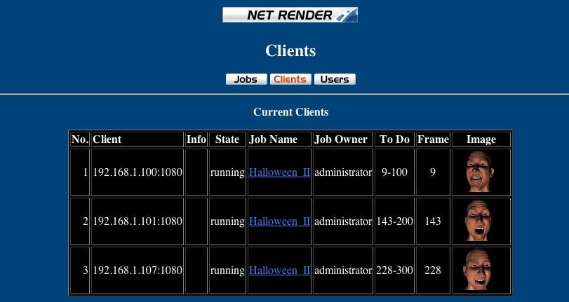

In the XL Bundle with C4D, don't underestimate the power and ease of use that Net Render provides. My home office is not the best example but I put it through a test last night.
A simple animation of a face, done in C4D - Wes Head
Systems used:----------------------------- Frames Rendered
My G5 DUAL 2GHz--------------------------146
eMAC 800 MHz------------------43
Windows machine 2GHz--------111
The animation took 20 minutes, twice as fast as rendering it on just the G5 alone. Not bad, it's like having two G5's.
You see my point, in a well suited architectural office, one that has many dual processing machines (Windows or Mac), the idea of distributed rendering can get you to the finish line much faster. Net render is provided free with the XL Bundle for 3 clients and it can be expanded to 10 or more as a upgrade.
