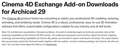

lol aren't you grumpy. No I mean actually Cinema 4D 😂 exactly how archcicad itself refers to it? I know you had probably need to correct me, but I think I can explain myself well without "correct" terminology. Thankfully, the rest of people here understood it.
https://www.graphisoft.com/downloads/addons/cinema_4d/cinema4d_download/

thank you, I appreciate it! Maybe I did not use the correct terminology but archicad literally calls it Cinema 4D on their site so how am I suppose to know it is something else.
Anyway, Thank you for not entertaining the drama.
Regarding the renderings. My team use 3ds max for prominent rooms (open space, master bed, powder room..). For the standard rooms I have always provided elevations but the problem with that sometimes is, that the contractors/builders often miss a lot of details, swatch finishes, etc. (it does not happen all the time and all the rooms but it is common enough for me to do some "simple" renderings. But I prefer to do it in archicad.
also because I never used archicad for renderings in general, and did not like the "creative imagining" (have no idea if thats correct terminology but that's how I see it in archicad menu) , I did little research and found the Cinema 4D (or however else they call it).But It wasn't clear whether it Is another software or built-in archicad. Or if there is anything else I can't use for free. (to me the archicad is already quite expensive so I was hoping to have some reasonable 3D maker built in?)
