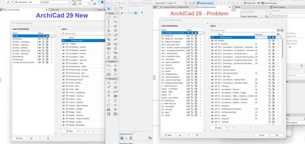

I am interested to know if someone has experienced this bug and if there is a quick solution.  I have only experienced this in ArchiCad 29.
When trying to change the layers visible using the layer combination nothing happens.

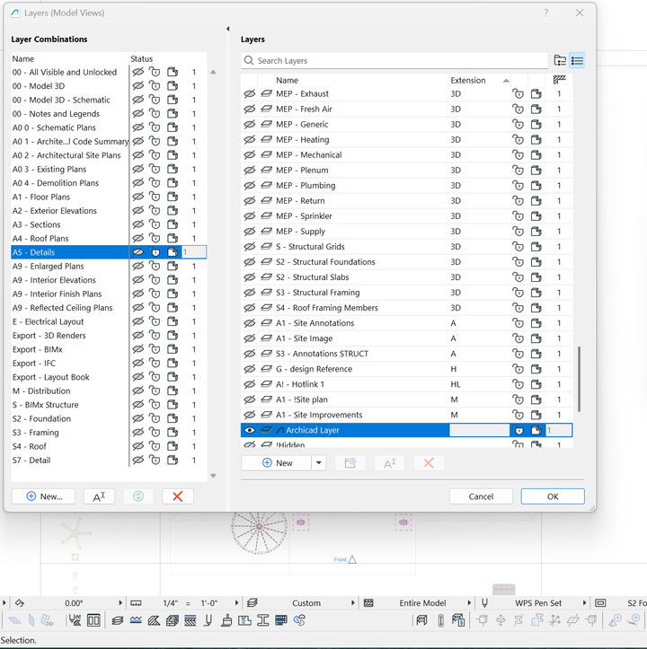

If you change the setting in the actual layer, it will only be temporary and will reset as soon as you use a layer combination
When you select the actual layer on the right it will show its settings in each of the layer combinations on the left.
So you need to select the layer you want to change and then change the settings in as many of the layer combinations on the left as you want.
That will set the properties for those layer combinations for when ever you use them.

Because the "Archicad Layer" can never be turned off, then it automatically turns back on when you change the layer combination, hence showing "Custom" in the layer combination drop down.
You will have to manually make visible the  "Archicad Layer"  in each layer combination,
In the right column select the   "Archicad Layer" ,
Then in the left column click on the "eye" symbol for each layer combination- that automatically updates the layer combination to include the  "Archicad Layer"  turned on.

So I selected each layer combination and each has the ArchiCad layer on, however, when I select the ArchiCad layer, all of the Layer combinations are off and refuse to change.  I cannot change the status of the ArchiCad layer.
