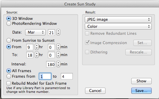

As far as I know, the Sun Study parameters are global. If they could be set per-view, then since the Sun Study can save images rather than a movie to a folder... and the time increment can be set to 3 hours (180 min), it would be a way to reduce the number of views.
Artlantis sun studies (an animation with only the sun info changing) are per-view, so you could create three views (one for each day - each view generating the 3 hour increment images) there...and the batch render feature generating all images for all views when you need them. You could even make the timeline jump to the other dates so that one 'animation' would generate all 9 image files.
