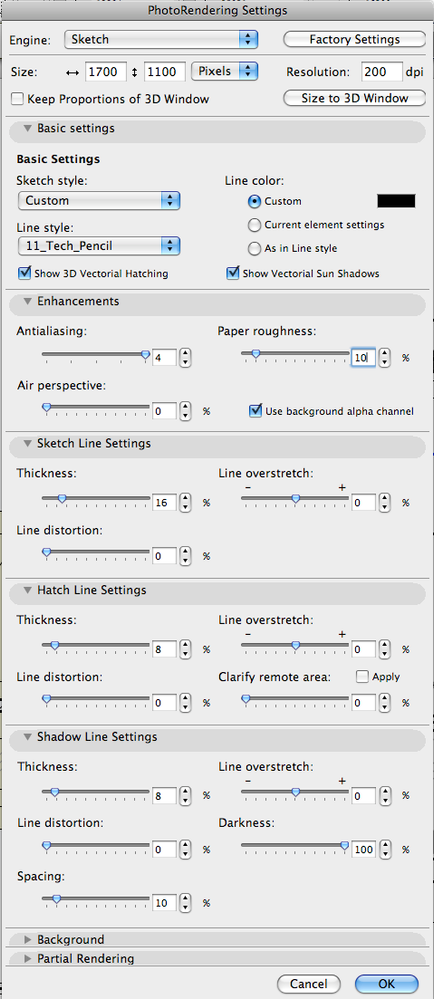

The settings I am using came from other people's posts in this forum, thank you to those who shared their knowledge earlier.
Start with Kor-I-Nor and adjust settings to match.
Tip: For internal sketch renders with shadows, turn Shadow Line Settings: Darkness down to approx. 20 or to taste.

those settings are perfect i just tried it on one of my current jobs and its exactly what what im gonna be using from now one.. thanks for posting them. only thing i did change was teh darkness of the shadows.. from 100 down to 60%
thanks again
