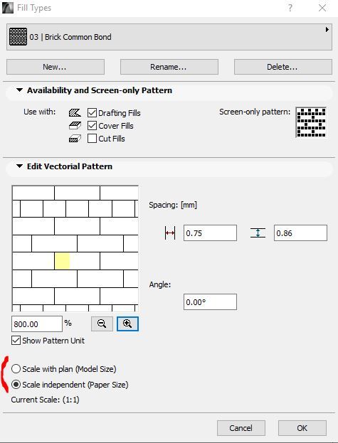

How do I make surface fill appear under a shadow in elevation views? See attached image. For some reason the stucco fill appears under shadows but the siding and stone (under handrail shadow) are not visible.

Try setting the fill to a 30 or 40% instead of solid.

Thanks for response, I tried all of the levels, even TRANSPARENT with no change in render. I'm wondering if there is something else controlling this. How is it that the EIFS fill is working as expected on the same render, but the others do not? I even tried to change the insertion priority on the siding wall building material to match the EIFS wall. I also compared the fills used, can't figure out how one differs from the other.

Try changing the vectorial fill setting for your surface material as per image below....seems to do the trick for us.

We use a diagonal lines fill for shadows, that works with this.
