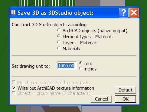

I installed both demo programs and they launch just fine in OSX 10.3.4.
So I exported a model that I have recentlly completed in AC 8.1 the latest build, and exported a 3D view using the default settings for both 3Dstudio ( which C4D just fine ) and Maya.
The .3ds file took about 3 minutes to process as this is a fairly complex model, same for saving as an Artlantis 4.5.6. file.
The Maya export simply hangs after creating about 3 different AC scratch files. I tried the same file on three different G4s same problem. It just seems to get stuck in processing hell. I get the little colored spinnig ball.....and nothing.
Is this a bug with the export plugin for MAYA in AC....or is there an obvious technique I am missing.
BTW, I saved from a 3d perspective view with the Open GL shaded mode.
Using OSX 10.3.4 on G4s...........any tips or help would be appreciated.

Miki wrote:Miki, thanks for the reply. .3ds definately does not get recognized into Maya PLE version. Do you know how to activate the plugins in Maya?
Try export as .3ds or .obj. Import into Maya (you might have to activate necessary plugins in Maya).
I will also try exporting to the .obj, though I don't remember that as being an option.
Thanks again,

Activation: Window -> Setting/Preferences -> Plug-in Manager.
Unfortunantly I cannot say what options You have on OSX

Miki wrote:Miki,
It should be as "Wavefront File (*.obj)".
Unfortunantly I cannot say what options You have on OSX.
Thanks again. I was able to create the (.obj) file saving as a Wavefront file. Actually it creates both a .obj file, and .mtl file. After trying to import into Maya PLE v5, I got an error message that the file was not readable. Then a suggestion to "import" is given. Tried that, nothing.
Don't know if this is a problem with the way AC writes the file, or if Maya is acting up. Have to say C4d imported the .3ds file quite seamlessly...the interface seams like it requires more time than Maya, at first blush.

rm wrote:I had similar difficluties exporting AC 8.1 .3ds files to use with the 3D max 6 Demo with Vray. I was able to make it work very well by changing the save as settings in AC and then importing that file into 3D Max, then saving as a .max file. I was not able to get the Vray add on to work with the Demo version yet.
