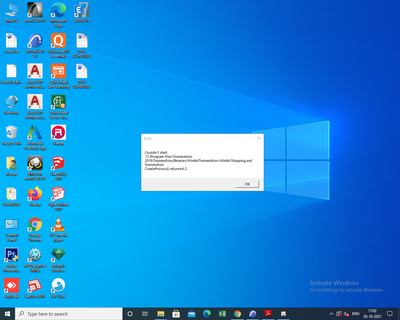

I am getting this error, after installation.
I have worked one day, on the installation day itself.
Next day when I open the twinmotion, I am getting this error.
How to correct this?? please help me in this.
