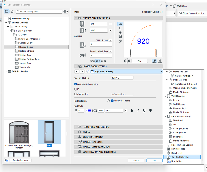

2026-06-18 10:34 AM
You are on to something there.
I just added the original 28 mapping table found at the bottom of this page ...
https://www.graphisoft.com/en-au/downloads/?section=mapping-value-table&localization=AUS
The rest are all just updates and not the full mapping table.
Maybe they should be installed as well - I think each "added parameters" table might need to be added just so they are upto date with the latest library.
Assuming the library has been updated as well.

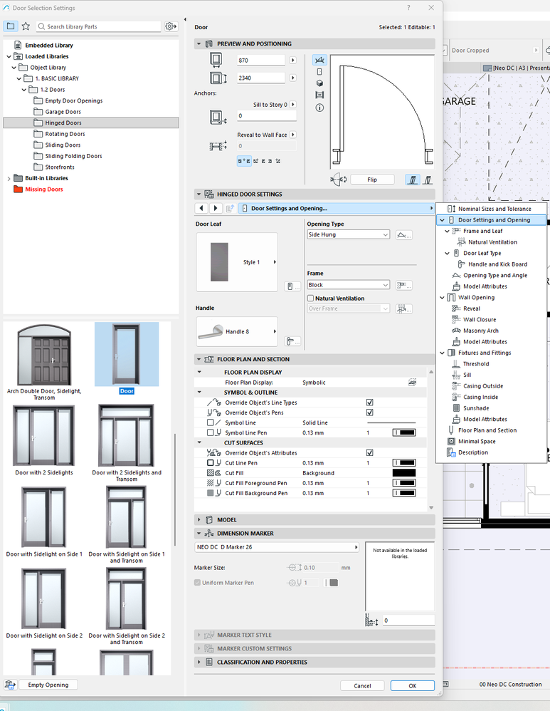

Now I see the tags & labels page.
There must be a parameter in the objects that turns this on/off.
But that seems a bit strange to me.
I see a parameter to turn the actual tag on/off or use the MVO settings to show them, but not one to show/hide the UI page.
I will investigate one day.

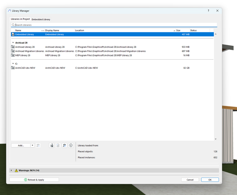

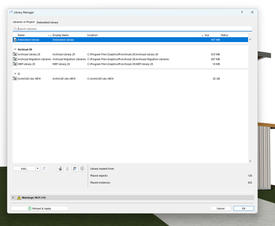

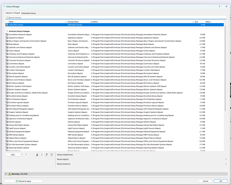

No i am not. I have attached the photo of 28 libraries.
2026-06-09 07:07 AM - edited 2026-06-09 07:14 AM
The folder you loaded is indeed the legacy library. If you look in the folder you had loaded in AC28, you will see that it is actually just the AC27 library...
The issue here is that with the change to Library Packages there is no automatic migration as almost all of the object IDs and some of the parameters and options have changed. I think they have released a few tools that will help convert between them, but ideally you you start from scratch. For older projects, it is best to continue loading the legacy library, though it is not included within the AC29+ installation.
There are a few other posts around here regarding the migration to library packages.

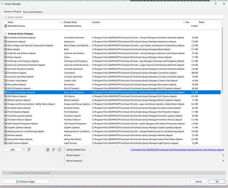

I have linked the latest Archicad 29 library packages to the template. The screenshot I previously shared was from my Archicad 28 template, where I was still using the older library system.
The issue seems to be happening even though the template is now linked to the new Archicad 29 library packages, so I am wondering if there is something else I may have missed during the migration process.

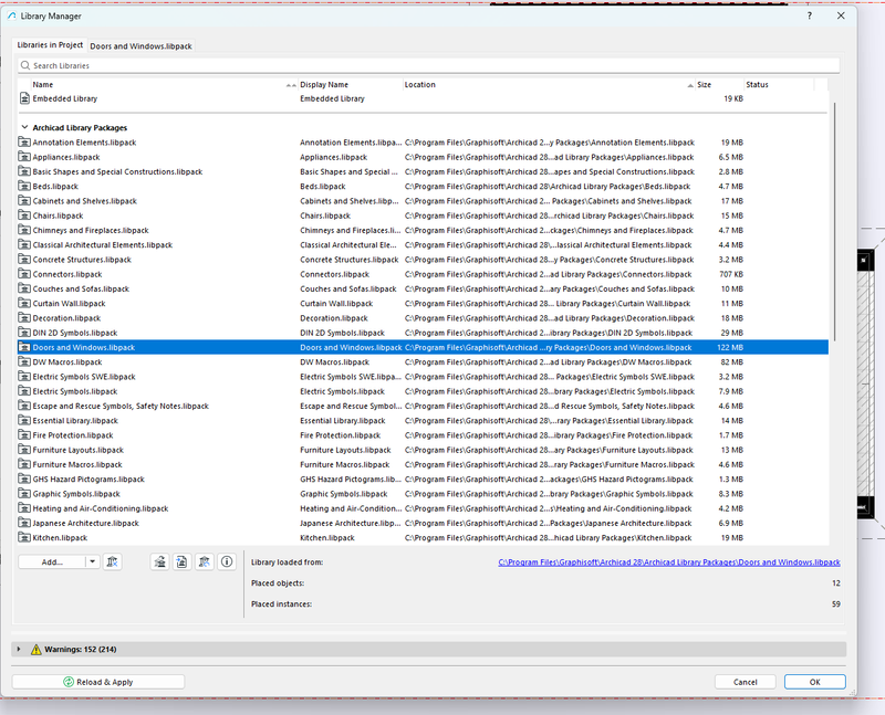

Also Is there a way to implement option 2. Migrating to Archicad 28 and Converting to Global Libraries when you have already migrated to archicad 29?
I used the below progress when I migrated from archicad 27 to Archicad 29 template.
2026-06-09 07:41 AM - edited 2026-06-09 07:46 AM
The steps should be all the same, it is all about the change over from the Monolithic Library to Library Packages rather than between AC versions.

2026-06-11 05:43 AM - edited 2026-06-11 05:43 AM
My query is that the Tags and labelling in the door settings dropdown isn't showing on my template. I am not sure why this maybe?
