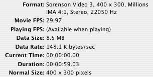

David,
I find that when I am looking for information about on-line web movies, I download and view the work of professionals, then use the SHOW INFO requester in the QuickTime movie player.
For example, this link:
http://www.cgproshop.com/product/000010/
Delivers a 8.8Mb Quicktime file. If the Sorensen codec is good enough for the pros, it will probably be good enough for us.
Also the Apple QT web site :
http://www.apple.com/quicktime/
Offers plenty of other examples, download view and then check out the INFO for codec used, frame rate, size, data size, etc.
Find the one you like best and then try to duplicate their efforts.
