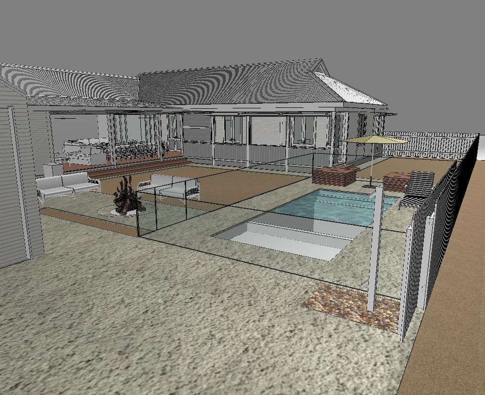

I'm not sure, but i think the problem mentioned in the O.P. occurs in the 3D window where two transparent objects overlap. I've been encountering this regularly and haven't been able to pin down the responsible settings. I also use VBE and when it occurs, the problem seems to transfer to VBE files.
In the attached image (from 3D window, rendering with openGL), i have a semi-transparent water texture to the pool and a transparent setting (no texture) to surrounding glazed pool fence; when viewing through fence towards pool, it seems that not only water texture, but also water 'object' is not visible.

i did see dwight's post, however it would seem to relate to renderings.
the image i attached is from the 3d window (although with textures turned on). i have done trial renders of the image with both the internal rendering engine and lightworks engine and the water texture is visible through the transparent elements of the pool fence. This doesn't seem to be an issue. In any case, we are using mainly artlantis for rendering and not had any issues such as this.
The texture not appearing through other [transparent/translucent] elements is an annoyance only in the context of the 3d window, however my main problem is that sometimes it seems to transfer to output when using VBE (see previous post archicad-talk.graphisoft.com/viewtopic.php?p=147816#147816) and i don't understand if/where it can be addressed.

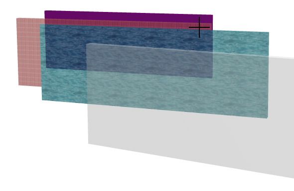

Dwight
While testing your proposition, I did momentarily encounter the block-the-water issue.
But here is an example of many overlaid, partially transparent textures that seem to work.
