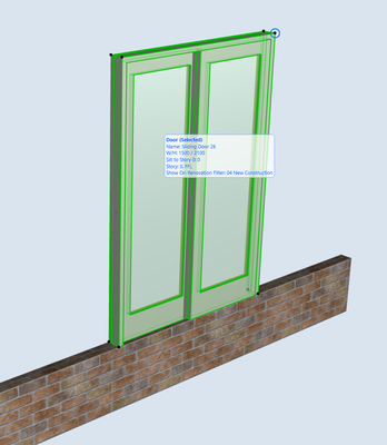

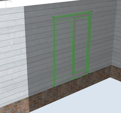

Hi, I'm looking for some help to remove the wall from my sliding door. I realize the walls are meant to host the door. I have both the wall and the door in new renovation and all of my other doors (none this type) display correctly.
Solved! Go to Solution.
10 hours ago
Do you have adjacent walls in which this door might be placed in? Door only makes a hole in the wall it is assigned to.
Easiest way to check is, with the door selected, in 3D, press F5 and then it will show the wall & door. If the Wall is a different one from the one where the door is in the image, delete the door and re-place it in the correct wall.

Legend. Never even thought that could happen. I guess I just set it in higher.
