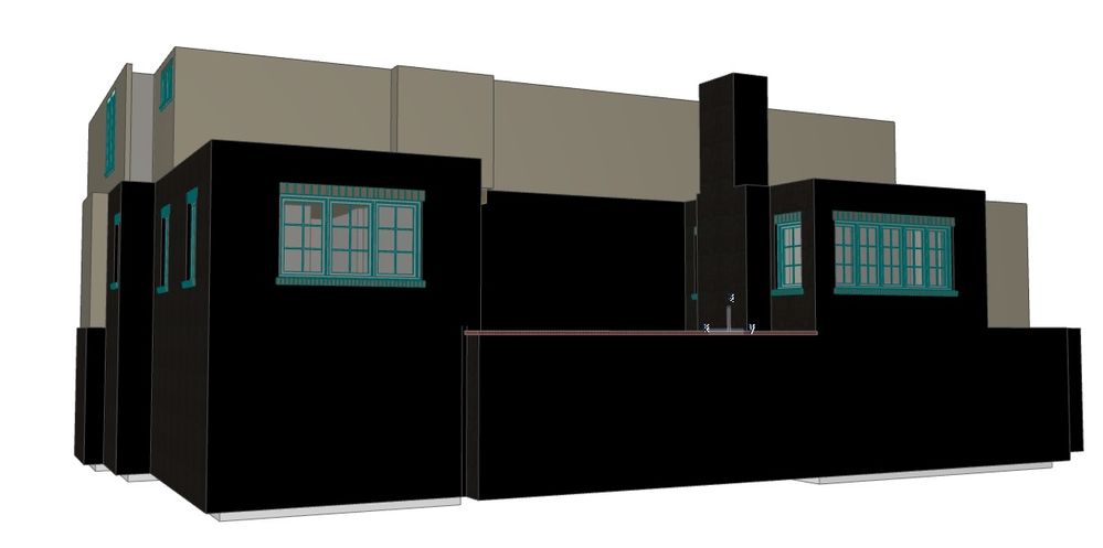

I already have that turned off. What I am seeing and do not need is like a realistic sun and shadows. I need that sucker to be bright on all sides. Here is a picture of how the back of the house shows. I need to be able to in real time spin this house around and have the same bright light showing on the back as on the front.

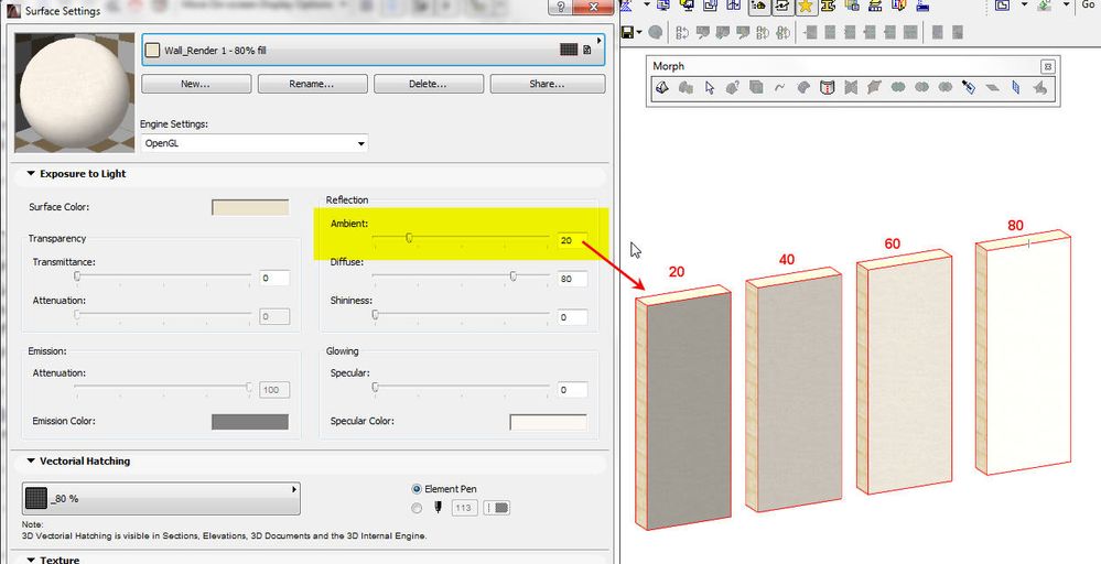

It is not so much the shadows being cast as the amount of sun and ambient light and the % of sun included in the ambient light as Erich mentioned.
Also the material (or I should now say Surface) settings will have an impact.
For example here is the same material but with different Reflection > Ambient settings.
Other settings in the materials may also have an effect as well.
