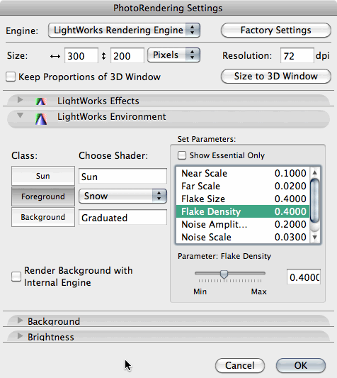

I noticed that is is possible in the render setting in archicad 16 to have on the foreground snow.
but i it possible to have snow on the road and roofs?
and how do you do it?

I have seen a setting for fog but not for snow.
Where is this snow setting?
Maybe we just don't have it in the hot Australian version.
i present to you the function snow
i do have the educational version

See attachment.
Guillaume van der Maas:
It is just a foreground scrim, not part of the model. You could create material textures for snow covered roof and road, but they would be flat (not add thickness).

Ah I see.
Yes I have that setting too.
It is simply just "noise" across your image that looks a bit like falling snow.
I can't think of any way to add snow to your model other than actually modelling it (that would be quite difficult and tedious) or creating materials that will give a snow effect (i.e. a snowy JPG image added to a material) - but that wouldn't look very good either.
You best bet would probably be to Photshop the snow into the render after it is done maybe.
As I have never even seen snow where I live there is not much call for me to experiment in that direction.
