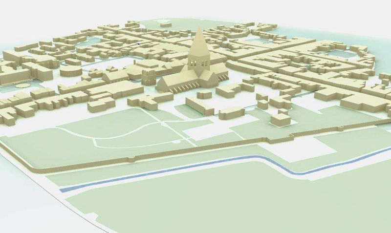

Hey all,
I'm currently modeling an urban site for a university project and am having trouble with the renders. I would like the site model to be nice clean white as if it was made of white card or something similar. At the moment when it renders it looks a little grey in many areas. Any ideas?

thanks for the adice tigr, its been really helpful. so far, here are the imagesim happiest with. please feel free to critique them as you will.
thanks,
Mark
and another
Looks like bad radiosity which is actually good.
Seriously, big improvement Maybe a bit more contrast would be good (less ambient light more sunlight). You don't need to stick with the numbers, it was rather a start point, but definitely we have some progress here. Glad I could help.
P.S. You might also try "sunset, sunrise color" switch ON in SunObject settings, sometimes it gives interesting results.
P.S.2 Remember about Brightness slider after rendering is done.
P.S.3 I couldn't help myself and mess with your rendering.
blimey, how did you manage to make mine look so much better?!
I used Photoshop, but you can do similar in AC:
- decrease ambient light
- take a bit from skyobjects and give a bit to sunobject for better shadows
- make your grass less colorful and more dark
- use afterrender brightness setting to improve contrast
Thats all.
