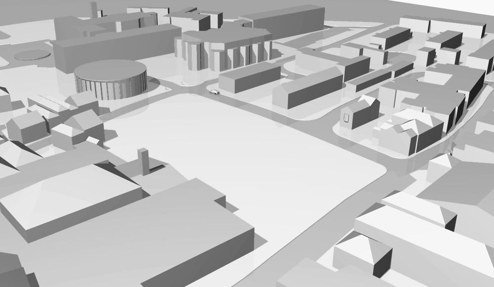

Here is what i have so far, still looks really grey...
Dwight
Get realistic!!!!!!!!!!!!!!!!!
Use colored light.
Make the sun tint yellow and the ambient and skylight and undersun blue.
This will enliven your image.
Dwight Atkinson

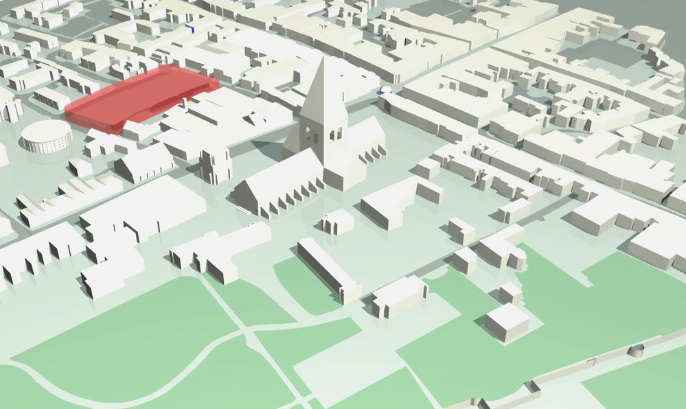

thanks for all the help guys,
i have tried all the suggestions and have come out with this image.
its (in my oppinion) much better and is more the effect i was going for.
by the way dwight, are there any copies of your book still available? by the sound of it, its well worth investing in.

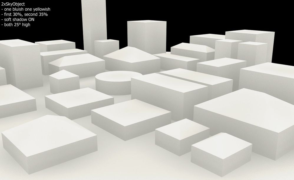

Not bad for a start.
I work with AC 9.0 so couldn't play with sun shader but what I did was:
1.Lightworks setting -> Light sources -> Ambient 56%
2.No other light source than Sun and SkyObjects, manual positioning
3.Material settings:
*Color - plain white
*Reflectance -> Matte -> Ambient 3.0, Diffuse 0.3
(high ambient and low diffuse is a key to get soft, light material with no burn outs even with strong sun light)
*Displacement -> Rough -> Scale 0.02, Amplitude -0.05, Detail 3, Sharpnes 4
4.When looking straight - key light on the right hand (around 5 o'clock)second light on the left hand (around 8 o'clock), I'm talking about direction of course, not actual time
5.When rendering is finished, before save, open PhotoRendering Settings -> Brightness -> tweak, apply, if satisfactory than save
6.I attached also combination of Lightworks and Sketch which I'm a great fun of.
Below are the results.
Now tweak, play and post something. Cheers
