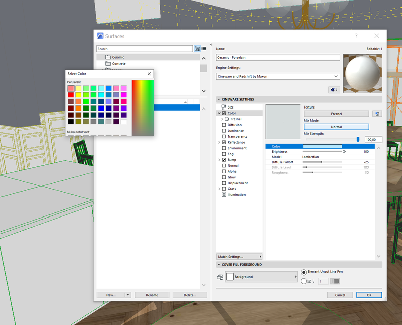

As you can see the box is partially visible and I can't select the colours anymore. I have restarted all multiple times.

Do you have your windows screen scaling set to 100%?  Any other setting can result in problems like you show.   Also is your display driver (and all Windows Updates) up to date?
To clarify about technical questions… the answer you received to ask here is because you have a free educational license, which offers no technical support,   This community is not technical support either… but often someone here can help solve your issue,
