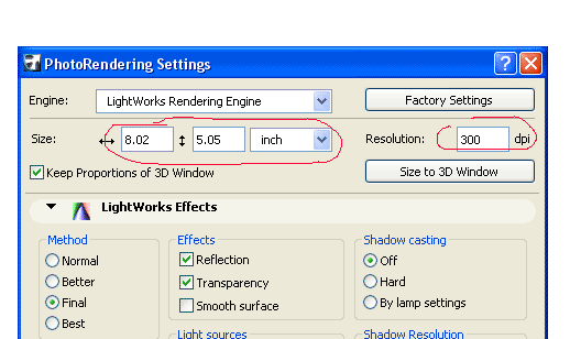

I am trying to get my 3d archicad model , into photoshop for extra editing in A1 size .... ii need good quality renders ... i dontt know to to do it

However, for now look at;
Document>Creative Imaging>Photo Rendering Settings.
You might not want to use Lightworks (try Internal) it might be easier to control, but you should get the idea.
This is where you control rendering quality/Size to final output to PSD or Tiff etc.
If you set low values here you will be fighting an up hill battle.
Then after all these settings, and assuming you get something you like in 3D,
and while you are still in 3D window; Now save-as (say) MyBestRender.psd to where ever you want to store it.
