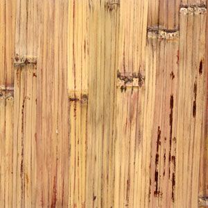

this is my sample picture where i need to be a textures.
Dwight
Swell image, but if the walls are to be bamboo, how are they assembled? Is it a bunch of bamboo stalks side by side? Show me a picture of a structure.

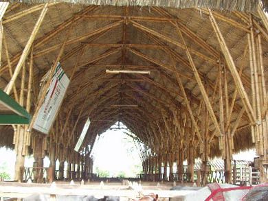

i give you a sample how did the bamboo assembled for structure of the house, but in this sample i would like to show you how Ganjuran emergency church in Yogyakarta, middle java, Indonesia, had made by local peoples with directed by engineer.
The old church was shattered by Bantul, yogyakarta, earthquake 5.9 sr. all component to build structure are by Bamboo.

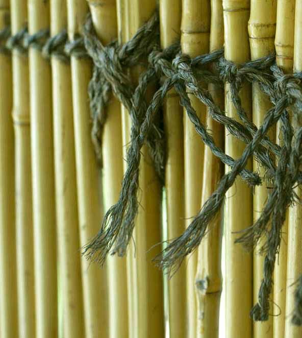

sorry, i'm forgot to explain how to assembled bamboo to be wall. there are much way to use bamboo become wall, we can assembly with side by side model, we can make laths by cracking, plait model and so on. i'm sorry i don't have pictures, someday i will post for you
bamboo plait
flattened bamboo
wall bamboo

Okay. You want to make a series of bamboo columns and framing pieces to start. For a bamboo pattern like your bamboo board, you make that like any other texture using a flat, full on seamless picture. Study any textured material [like brick] and imagine substituting a picture of a bamboo wall in there instead.
Making textures involves getting an appropriate image and sizing it in the material dialog.

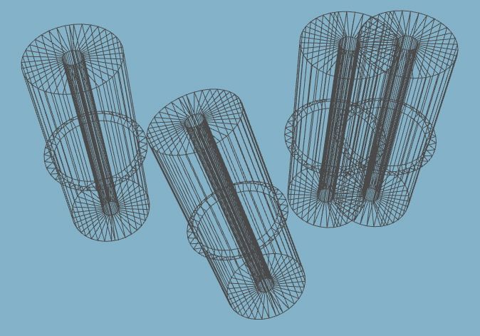

Draw a small circular wall using a complex profile, similar to a revolve in creating a circular section. Now you have a bamboo......
To tilt the bamboo for braces is trickier:
The bamboo column created with the complex profile and wall tool must be saved as an OBJECT, then again as a special Archirotate object using the free Cigraph tool ArchiRotate to tilt it.
