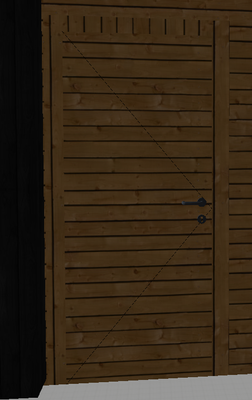

I am trying to model some doors that will show up in 3d views, internal elevations and schedules. The doors will have a slatted texture/cover fill to the frame and leaf that requires the same orientation. I have created variations of the same texture rotated 90 degrees from each other so the frame and door leaf textures are orientated the same:

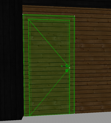

they are showing up correctly in both 3d and internal elevation:
I'm also happy that when the frame and wall material are the same, they blend together and the frame becomes invisible, that is the arch intent.

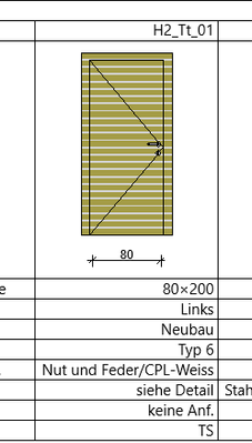

The problem is then the schedule.  the door frame texture is now showing wrong.

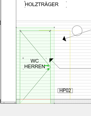

The model view options are the same (I understand that showing doors in simple or detailed modes affects the texture orientation in views) in the schedule/internal elevation options, there are no graphic overrides. If i change the frame material to the other texture:
it now shows correctly in schedule but incorrectly in 3d/internal elev.
So the schedule view is reading the correct material, just choosing to display it incorrectly. The door object is the 'Blockrahmentür 1-Fl 27' which seems to be AC standard, not some janky imported pirate object.
