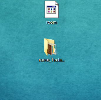

the problem appears when it comes to open the atl file, it says that file cannot be loaded,
when i open the atl file it looks like this

Mystery. Have you tested with a fresh project and just a single wall, for example? I've not heard of anyone having an issue.

the results are the same, thanks anyway , I will try to fix in an another way,
