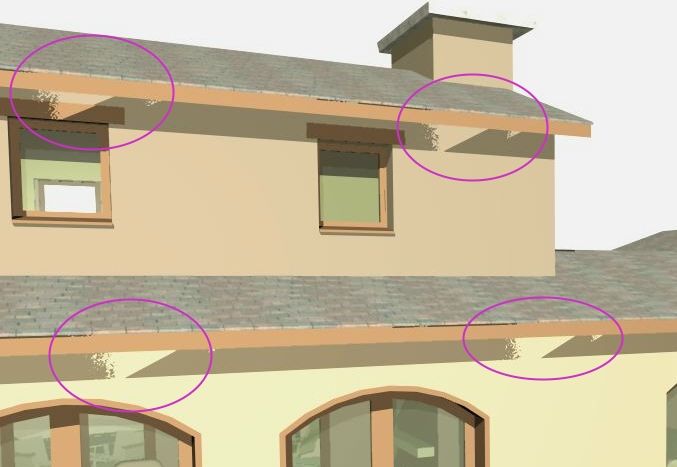

inconsistant Lightworks shadows

Here are my Lightworks settings

Been fiddling around and discovered that the holes in shadows are triggered by transparency and goes away with hard shadow casting.

You could increase the Lightworks Effects "Method" setting to Final or Best.
And do you get the same shadow problems with Realistic Sun?

s2art wrote:Method setting to best has same results. Realistic sun cures it but so sloooow. Hard shadow casting will work.
Thanks!
