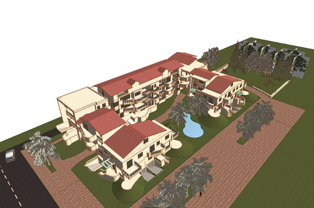

i want the material of the pavement to look like the opengl file i attach but when i render it in lightworks it appears like pink and blured.
what can i do to make it look like the opengl???

In the case of texture maps only (excluding shaders), the way to make textures appear similar in OpenGL and in the LightWorks engine is to start by placing the material in the material dialog for the ArchiCAD Internal engine. This is the place OpenGL refers to when making a texture.
Explained on page 9 of my book.
Then you use the "Match Internal..." button to establish the texture in LightWorks.
But of course, it flips the texture, so you must flip it back.
This is detailed on page 114 of my book
BTW: The rendering engines DO work differently, so they will always differ in appearance. Also OpenGL cannot mirror textures.

you are right i do it like you say i see it in internal and then match in lightworks but it doesnt match at least it didnt
i checked it out and i made it thanks a lot
